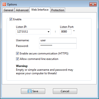

Enable Web Interface
Open Options via the
button or from the main menu and navigate to the tab called "Web Interface". All of the settings will be disabled (grayed out) by default. Put a tick mark on the "Enable" check box to enable the Web Interface and its configuration.
Configure Web Interface
Listen IP and Listen Port parameters define IP address and Port number through which Web Interface will be accessible. Port number can be any numeric value in range 0 to 65535, but it is recommended to use values above 1024 as many of the the ports below this value are reserved by the system and standard applications. Choice of the IP address depends on the desired accessibility of the Web Interface.

To check whether specified IP and Port parameters are acceptable press "check port" button.
- For example, if you set IP address to 127.0.0.1 and port 8080, you will access the web interface in your browser via URL: http://127.0.0.1:8080/ or https://127.0.0.1:8080/ (if HTTPS option is enabled).
Username and Password can be anything (however, always use a strong password). These will be required to access the Web Interface from a remote PC.
- Short or easy to guess Password can introduce a security risk so be careful while selecting your password!
Allow command line execution – allows users to execute arbitrary commands on the host machine and enabled additional process management facilities.
- Command line execution should be used with caution!
Enable secure communication (HTTPS) – protects the transmission of credentials and other instructions from eavesdropping using SSL/TLS encryption protocol.
- Shutter uses a self-signed certificate to secure the communication. By default, browsers will not recognize this certificate as trusted, so you will need to allow it or add an exception when prompted by your browser.
