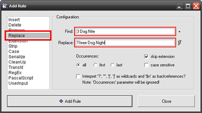

Icon Step 2.gif Create rules which will change the file names. Once you press the button, a separate dialog will come up with a list of available rules and their configuration, as show on the screenshot below:
