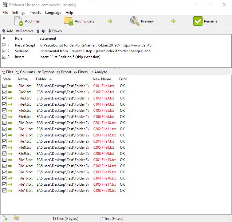

#9 2019-01-06 02:27
Bluebear
Registered: 2018-12-31
Posts: 5
Re: Feature Request: Serialize Increment on folder change
Thank you so much Stefan, and my apologies (again!) for the misunderstanding
The script works perfectly which I modified slightly for the desired outcome as follows:
// PascalScript for den4b ReNamer  , 04.Jan.2019
// [url]http://www.den4b.com/forum/viewtopic.php?pid=10672#p10672[/url]
// For each Folder add the same digit to all files, increase digit if Folder changes.
// You may add column "Path" and sort by Folder name first, then Preview before renaming.
  SerialNumber: Integer;
  CurrentFldName, LastFldName, SerialString: WideString;
  CurrentFldName:= WideExtractFileDir(FilePath);
   If (CurrentFldName <> LastFldName) Then
      SerialNumber := SerialNumber +1;
  //Pad SerialNumber to wanted length:
  SerialString := IntToStr(SerialNumber);
  While (Length(SerialString) < 2) Do
          SerialString := '0'+ SerialString;
  FileName := SerialString
  + WideExtractBaseName(FileName)
  + WideExtractFileExt(FileName);
    LastFldName := CurrentFldName;
https://www.den4b.com/forum/img/members … screen.jpg
Hopefully I have posted this correctly and I look forward to this implementation in a future version.
Kind Regards!
