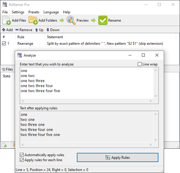

Rnmr wrote:
Dennis' solution appears to only deal with the target words and leaves out all the other ones...
The Rearrange rule uses regular expressions under the bonnet, but with a goal to expose a more simplified set of options for rearranging parts of the filename. The Regular Expressions rule offers more features but at a cost of increased complexity.
The Rearrange rules mentioned previously will work with filenames containing any number of words. That is the benefit of the "Exact pattern of delimiters" option, versus the default "Delimiters" option.
For example, move the first word of every filename to the end:
Online
