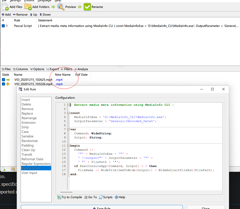

Can someone help? About ReNamer Scripts MediaInfo
I use this script, but it dosen't work
ReNamer:Scripts:MediaInfo
http://www.den4b.com/wiki/ReNamer:Scripts:MediaInfo

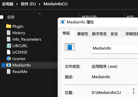

I have downloaded and installed MediaInfo CLI

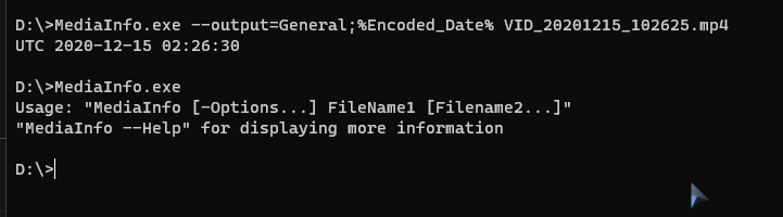

Open a command line box (cmd.exe) in the folder with your MP4 and test if they contain any info
MediaInfo.exe --output=General;%Encoded_Date% "here your.mp4"
Possible output:
UTC 2011-05-23 12:51:14
What do you get?
Try MediaInfo.exe  "here your.mp4" to see all media info from your file

It can output mediainfo
D:\>MediaInfo.exe --output=General;%Encoded_Date% VID_20201215_102625.mp4
UTC 2020-12-15 02:26:30

Fine.
For me it works. I get the date extracted. (with included invalid chars, but ok so far)
Which version of ReNamer do you use?
Is the path to MediaInfo.exe correct in your script?

{ Extract media meta information using MediaInfo CLI }
const
  MediaInfoExe = 'D:\MediaInfoCLI\MediaInfo.exe';
  OutputParameter = 'General;%Encoded_Date%';
  Command: WideString;
  Output: String;
  Command :=
    '"' + MediaInfoExe + '"' +
    ' --output="' + OutputParameter + '"' +
    ' "' + FilePath + '"';
  if ExecConsoleApp(Command, Output) = 0 then
    FileName := WideTrim(OemToWide(Output)) + WideExtractFileExt(FilePath);

There was an underscore in the mediainfo folder name, but now you have sorted that out?

Maybe change OemToWide to OemToAnsi?

I changed the folder name, removed the underscore, it didn't work too.

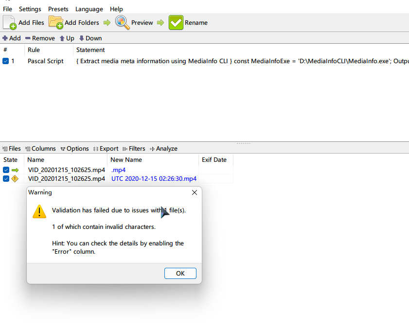

Ah, I got it. My Video file path contains Chinese characters.
And I have a question, how can i change the UTC time to my time zone?

Bingman wrote:
I Want to know how to make MediaInfoCLI recognize Chinese characters
Extracting Unicode content via the Windows command line interface is problematic, if not impossible in some cases. You can also find a similar statement on the MediaInfo website: https://mediaarea.net/en/MediaInfo/Supp … rt#Unicode
However, MediaInfo has command line options for saving the output to a file, with full Unicode support. I think it should be the "--LogFile" option, but you might want to check all available options via "MediaInfo --Help".
If you can provide a sample file, I can give it a try.
