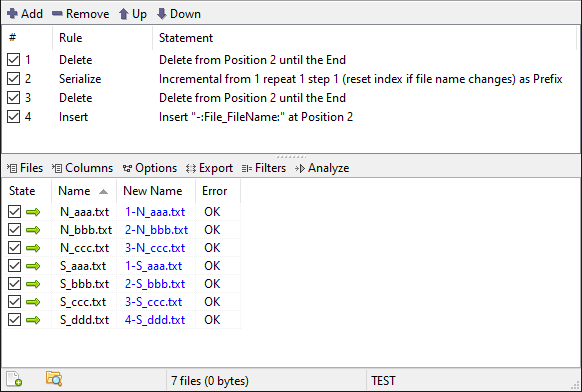

I would like to use the pascal code to do the following rename:
N_aaa
N_bbb
N_ccc
S_aaa
S_bbb
S_ccc
S_ddd
change to
1-N_aaa, 2-N_bbb, 3-N_ccc,
1-S_aaa, 2-S_bbb, 3-S_ccc, 4-S_ddd
How can I do it?
#2 2023-07-04 08:44
Posts: 3,544
Re: Serialize files on condition
This can certainly be accomplished with the Pascal Script rule, but you can also do it with the standard renaming rules.
Rules:
1) Delete: Delete from Position 2 until the End
2) Serialize: Incremental from 1 repeat 1 step 1 (reset index if file name changes) as Prefix
3) Delete: Delete from Position 2 until the End
4) Insert: Insert "-:File_FileName:" at Position 2
Here is a demo:
