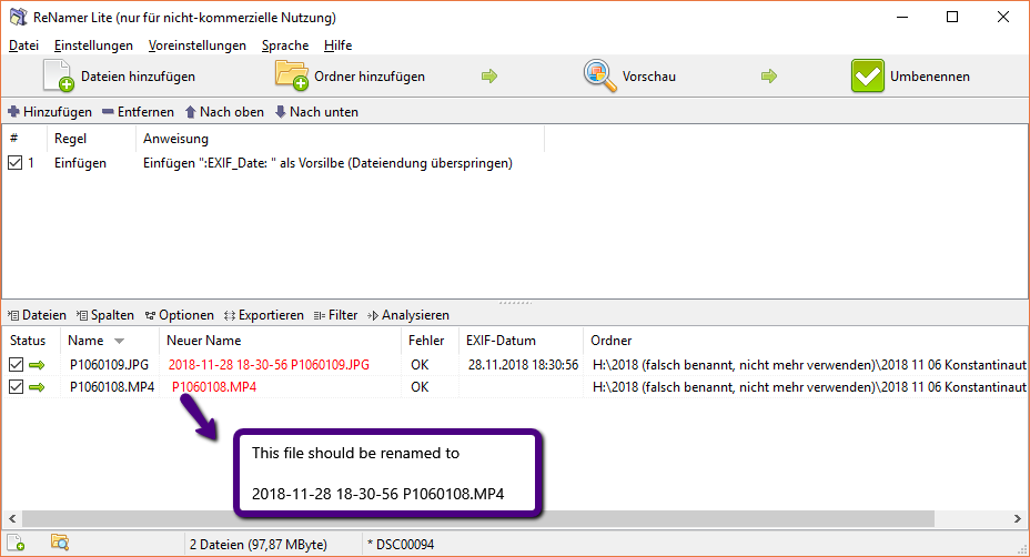

I'd like to rename the files given their EXIF date (for sorting reasons on my NAS). The problem is that the date only exists for the .jpg files.
Thus my idea is to give the .mp4 file the name of the previous .jpg in the list, even though it is not really the correct EXIF date, but I wouldn't mind.
Check this screenshot for an example:
In a first step, I could insert the EXIF date for the .jpg's, but then I'm stuck big_smile
I need a rule that says "if EXIF date ist not available, identify previous (already renamed) file name in list and use the corresponding EXIF date/first 19 digits as prefix"
Thanks in advance!!!

#2 2019-06-21 22:43
Re: File name = name of previous "valid" file in a list - possible?
Yes, that is doable using a Pascal Script rule:
  TagValue: WideString;
  LastTagValue: WideString;
  TagValue := CalculateMetaTagFormat(FilePath, 'EXIF_Date', 'yyyy-mm-dd hh-nn-ss');
  if Length(TagValue) > 0 then
    FileName := TagValue + ' ' + FileName;
    LastTagValue := TagValue;
  end
  else if Length(LastTagValue) > 0 then
    FileName := LastTagValue + ' ' + FileName;
  end
However, there is probably a date tag of some kind in your MP4 files. You should try some tag extractor tool, like MediaInfo CLI, and if it can extract a date, then you can use it within a Pascal Script rule. See this example: http://www.den4b.com/wiki/ReNamer:Scripts:MediaInfo
#3 2019-06-21 22:47
rebwa1
Registered: 2019-06-21
Posts: 3
It works genius!!!
Thanks a lot for your super super quick answer and great help!!!
