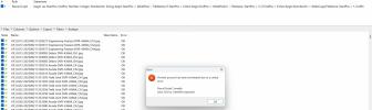

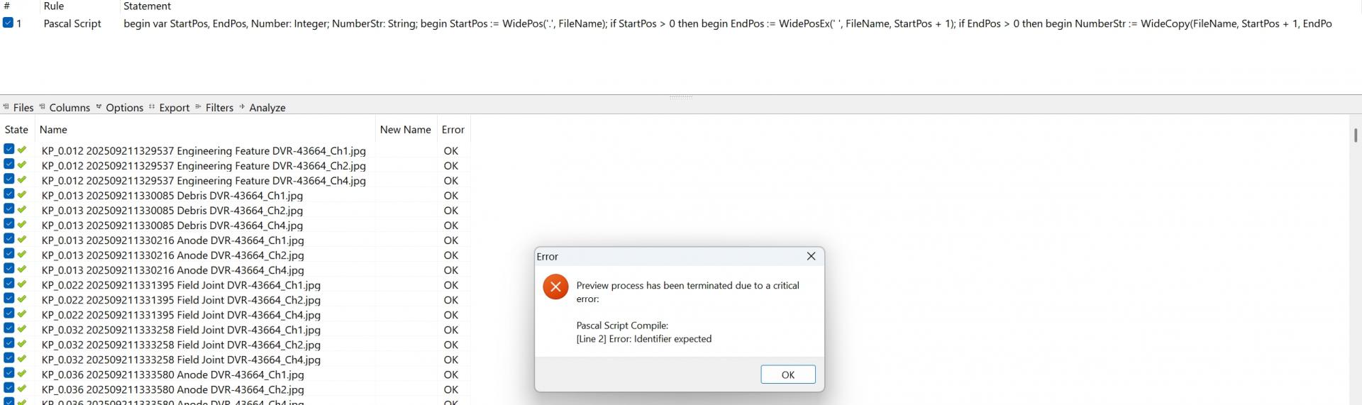

#5 2025-11-18 05:11
Remane123
Registered: 2025-11-16
Posts: 3
Re: 9000 survey photos wrong KP in file name
Got the attached error.
#6 2025-11-18 10:00
Posts: 3,517
Replace the entire content of the Pascal Script rule window with the script above.
