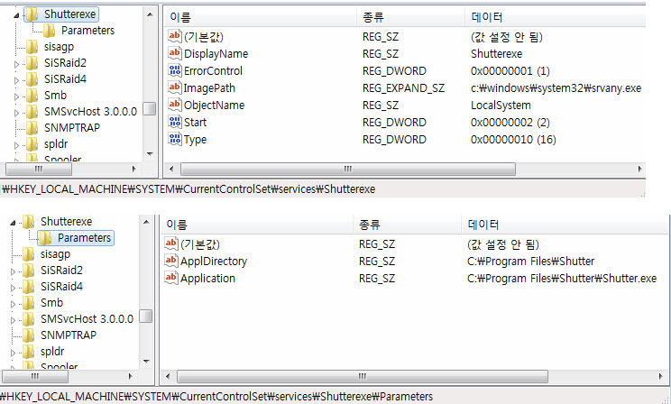

### third (success)
using instsrv.exe, srvany.exe
copy file.. instsrv.exe , srvany file to windows\system32
cd c:\windows\system32
instsrv Shutterexe c:\windows\system32\srvany.exe
regedit
HKEY_LOCAL_MACHINE\SYSTEM\CurrentControlSet\Services\Shutterexe
(please confirm image)

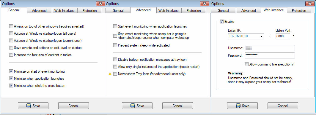

Setting of shutter my remote computer, please confirm image file
