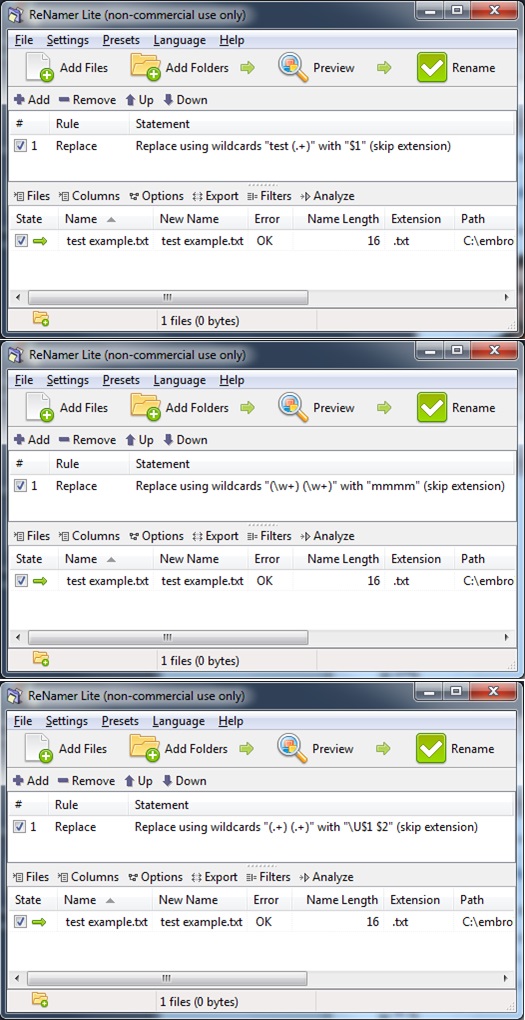

Please provide a screenshot and a preset file. Also, try manually deleting ReNamer.ini file (that will remove all your settings).

I've uploaded three screenshots.

"A picture is worth a thousand words"
Try using RegEx rule, instead of Replace! wink

Hooray for screen caps! I thought I had used those expressions before in Replace, but apparently I had actually used RegEx. Clearly my memory is not to be trusted. tongue Thanks much!
