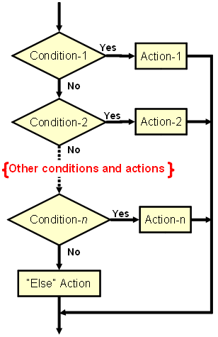

case/switch
case X of
  1:
      <Action-1>
    end;
  2:
      <Action-2>
    end;
  else
      <Default Action>
    end;
end;
This code structure has several <Action> blocks, each with its own condition.
  • Any given <Action> block is executed only if its condition is met.
  • One and only one <Action> is executed. After that, the control passes on to the next statement. (It does not check for the next condition.)
  • The conditions are checked in the "top down" order. So even if the other conditions are also met, their <Actions> will never be executed.
  • The code structure can optionally have a <Default Action>. It is executed if (and only if-) none of the conditions are met.
This is a generalized version of the if-then-else block (above).

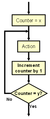

For To Do
for I := X to Y do
  <Action>
end;
Execute the <Action> a certain number of times.
This example shows that the counter is incremented by 1, but it can be any statement that changes the value of the counter vaiable towards the target value.
Similarly, the decision block can have any logical expression with the counter.
Make sure that the exit condition is reached at some point of time; otherwise the loop will execute endlessly, and ReNamer will appear to be hung.
