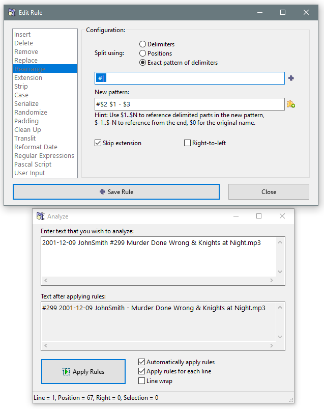

#4 2024-01-16 14:28
Re: Delimiter from $n to end of filename
autryld wrote:
The Rearrange rule did not seem to work, unfortunately.
You might have missed the required spaces around the split pattern " #| ".
Here is the demo of it working for your example filename:
#5 2024-01-30 19:48
autryld
Registered: 2024-01-09
Posts: 3
https://www.den4b.com/forum/img/members … e-2994.png
That's exactly what happened. Thanks for pointing that out.
