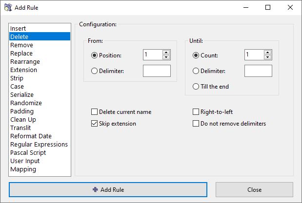

Delete rule
This rule deletes all characters located between the From and the Until positions.
Options
From
From which character-position you want to start the deletion.
Select from the following options:
  • The starting position (the position starts from 1).
  • The delimiter from where the deletion starts.
    • The delimiter can be a single character or any abritrary text.
Until
Until which character-position you want to delete.
  • Delete an exact number of characters.
  • Delete until the specified delimiter is reached.
  • Delete all characters untill the end.
Delete current name
A shortcut option for deleting the whole current name.
Skip extension
Right-to-left
Inverts the normal direction for counting a position, so that the count goes from right and towards left.
When this option is selected, the "till the end" option in Until deletes all characters on the left, what we normally regard as the beginning of the name.
For example, to keep only the four characters on the right side of the name and delete everything else, use:
  • From: Position 5
  • Until: Till the end
Do not remove delimiters
If you select this option, the delimiters themselves will be retained. Otherwise, delimeters will be removed together with the deletion range.
