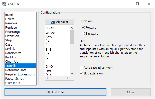

Using a built-in transliteration map
To select any of the built-in maps, press the TranslitMapsButton.png button. A list of available transliteration maps pops up:
Click on the desired transliteration map. As an example, let us click on the French (to English) transliteration map.
The Rules window changes immediately to show the French characters and their English equivalents.
You can edit any of the entry in this list, add new entries, or delete any of the entries.
Note that such editing does not alter the saved version of the map. The map is edited just for a one-time use. If you select the same Translit map again, ReNamer will load the original version, not the edited version. You will see how to alter a transliteration map in a section below.
Next, select the rule's parameters as shown below:
Parameter Details
forward This is transliteration from-left-to-right direction, as defined in the map.
backward This is transliteration from-right-to-left direction, as defined in the map.
skip extension If this check box is selected, the extension will be ignored by the rule.
Finally, press the AddRuleButton.png button to add the rule to the stack.

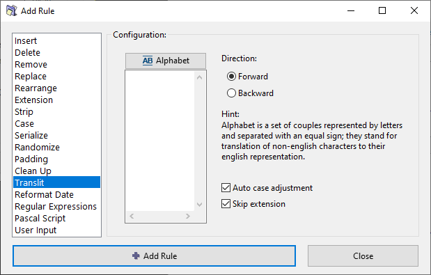

Making your own transliteration map
Click in the Translit Alphabet window, and start entering your custom alphabet.
Transliteration alphabet consists of two equivalence parts (or a couple), which are entered one per line and two parts separated with "=" (equal sign). Alphabet should not contain spaces and should have case discarded (case is adjusted automatically). Also, make sure to put couples which contain greater number of characters at the top, so they will get processed first and will not get processed partially by shorter representations. Below is a simple example:
щ=sh
ю=yu
я=ya
ь='
э=e
After entering all such transliterations, press the AddRuleButton.png button to add the rule to the rule-stack.

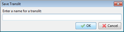

Saving a transliteration map
To save a newly composed Transliteration rule,
  1. Press the TranslitMapsButton.png button.
    A menu pops up.
  2. Select the last option (Save Translit...).
    A window pops up, as shown below:
  3. Enter a new name for the map and press OK. The new map is saved.
The process of saving an edited Transliteration map is similar. The only difference is that the Save Translit window (see above) shows the current map's name. You can press OK to save the changes you've just made, or enter a new name to create a new translit map for the edited version of the current map.
The new map's name is added to the map list.
From now on, the new map will also be available as "standard".
